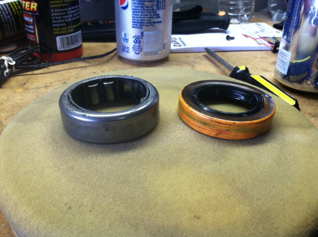

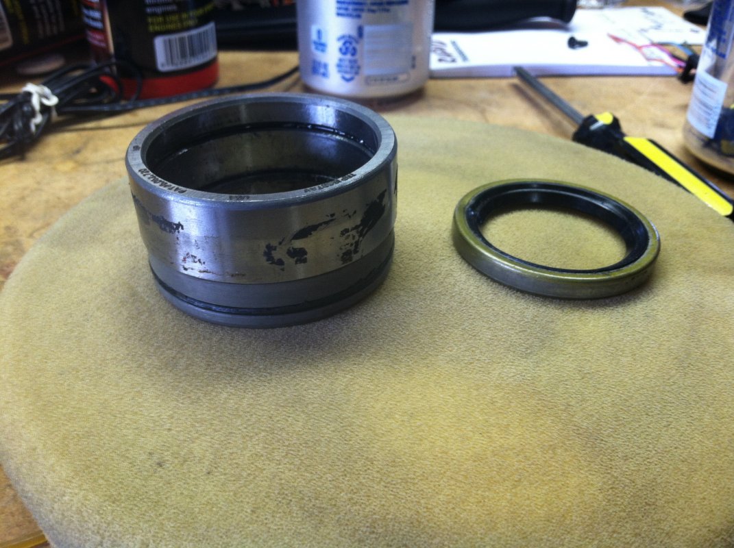

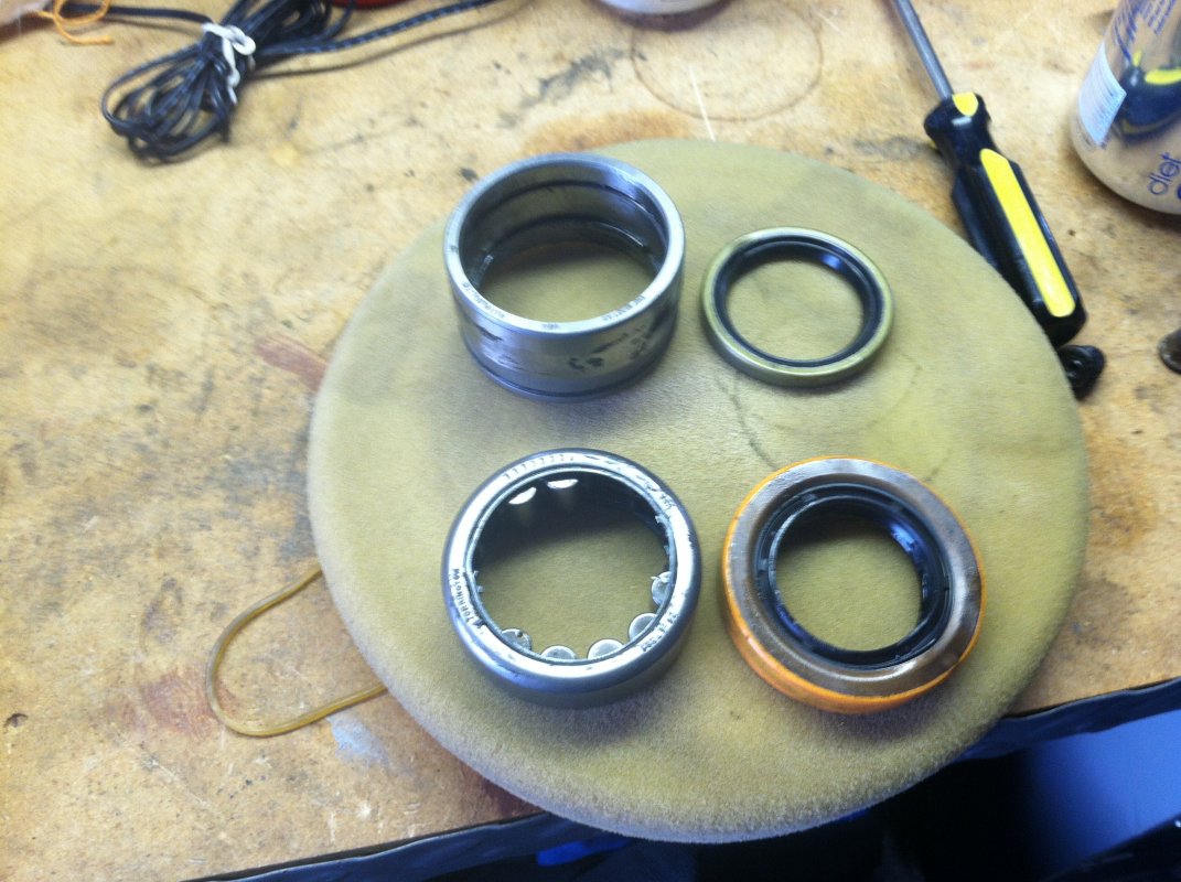

Replaced wheel bearing and mechanics on rear brakes: Pics are below. WOW...couldn't even put the same bearings on each side. OH!!!! Installed the WRONG bearing and seal on the driver side of the car. JBA is a JOKE and PLEASE.....NEVER take your car to that so called Performance Shop...NOT WORTH $100 an hour...not evern worth $10 an hour!!!
First Pic: wrong bearing, this is for my year car, but it has a plastic retainer vice the metal retainers on a performance bearing...the plastic was broken and the bearings were eating themselves. Perfomance Shop?? You decide!!
Second Pic: side by side
Third pic: right bearing with a metal retainer
Yes, I had to flush the axle to remove all the metal shavings.
