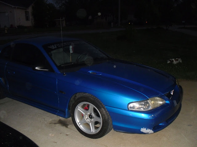

My turbo build
I started this a while back. I was wanting to have dyno numbers before I posted this, but I blew head gasket on the dyno. So I'm back in the tear down process. But heres the pics.

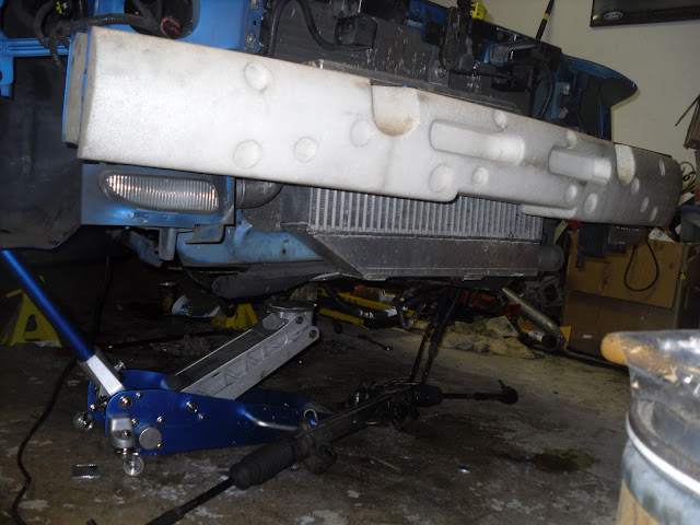

took to ac condensor out to mount intercooler and cold side.
mounted intercooler tonight. Started to take oil pan off too.

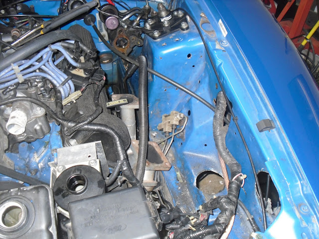

relocated coolant tank
neatened up the wire next and relocated my fuse box.

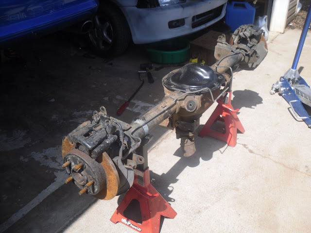

got another rearend today. Here what I picked up
found a use for my stock k member, LMAO My old rearend

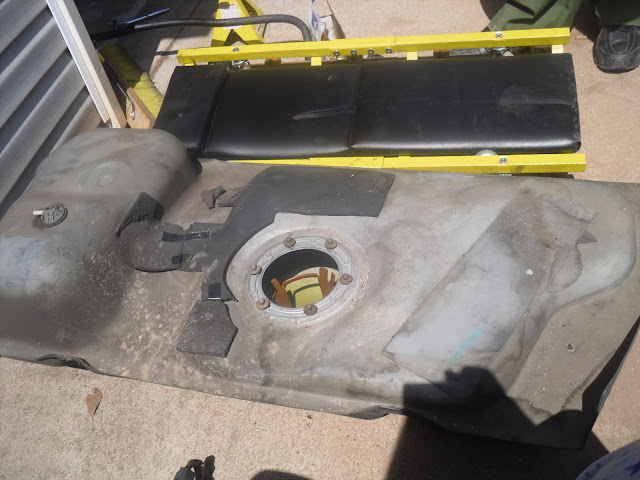

gas tank out and appart
hat with new pump in it.

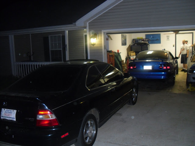

Thanks Tim for coming by and giving a helping hand.

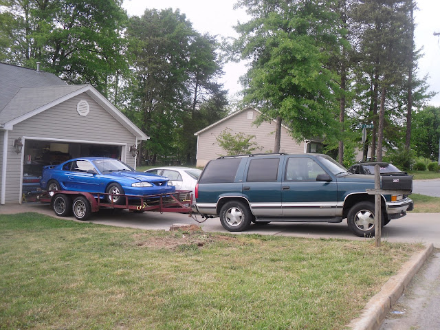

got the car loaded up. Im leaving at 6 am to go get her tuned. I can't wait!!!

the fore hat the Im gonna put in
it holds two walboro pumps that will cary my to 750 whp
