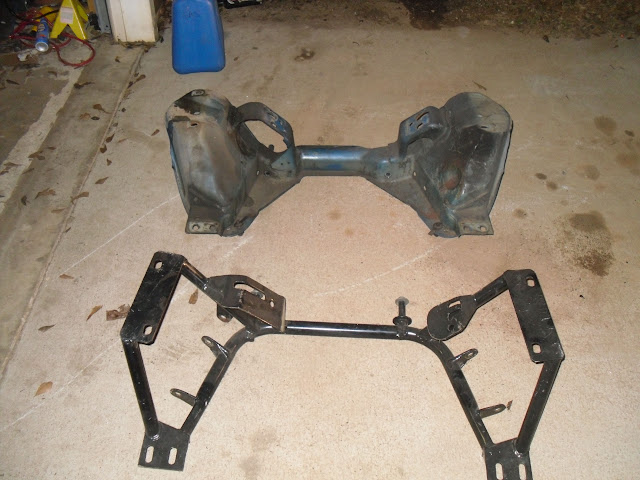

I started my tubular k member install today. Got the springs out. and the rack and pinion tied off and oll the bolts off except the main 4 that hold it on. I didnt want to it to be supported with a jack stand over night. Ill drop it out and install the tubular tomorrow. Im gonna use my stock a arms. I know Ill have to to grind a little off the back of the a arms to make them work. Ill post pics of it all tomorrow. Here the link that I used a good bit since it was my first time. LOL

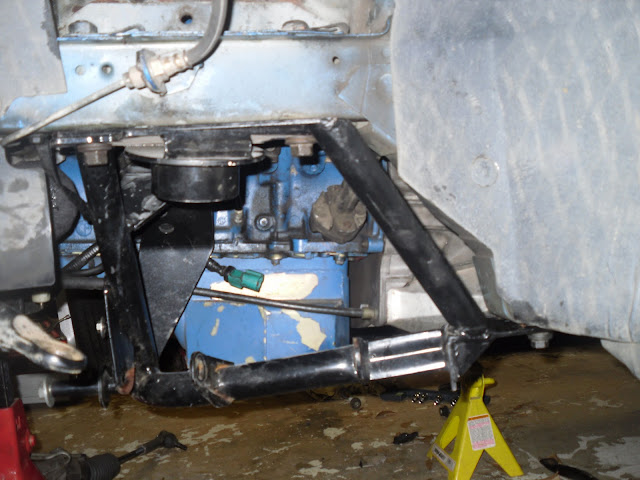

the way its looking everythings taking forever. Went to put the k member in and on the drivers side ive got to drill a hole for the motor mount tab. Went to take motor mount out and gotta take header out. Got 7 of the bolts out and decided to call it quits for the night. try to post pics in a little while
thats the tab i gotta drill for. To the right side of the bolt
i started cutting the a arms only to find out the cutter I bought must be made for a bigger tank. Its only cuts good for like 30 seconds before it looses air. So If got to get another cutter or a bigger tank, LOL. My is only a 26 gallon tank.

So you just had to drill that hole for the tab? Couldnt have just grinded down the tab? Im going to be doing a k-member swap with the motor in the car soon too. Any tips for me?
jack the motor up and use a tack stand on the crank pulley. I think I have a link on my post in this thread that followed doing the install. Its a good IN DETAIL video of an install.
The best way to install the K-member is to suspend the engine from the top using a cherry picker. That allows all the room on the bottom to maneuver.
Placing a hole in the K-member for the engine mount tab is the right way to go in my opinion.
